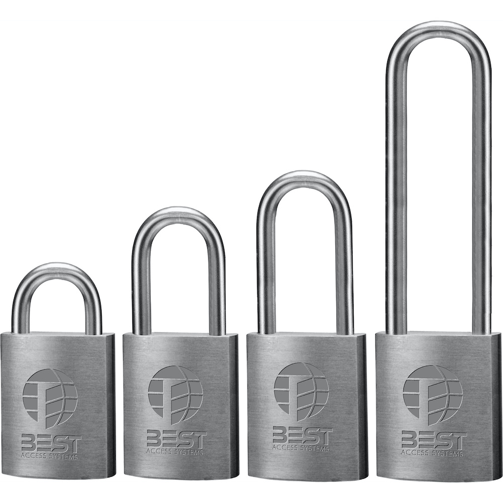

At the heart of every BEST padlock is a standard key removable core that is interchangeable throughout most of the entire line of BEST® Products. The standardization permits BEST locks of any type, size or style to be master keyed into one system which can expand to include future locking needs.
Padlock utilizes the interchangeable core which allows immediate rekeying at minimal cost.
Padlock function available in key retained and non-key retained.
*Please Note: Padlock does not ship with interchangeable core.*
Padlock Body:
Machined from solid extruded brass with a standard finish of 626 satin chromium plating.
Width: 1-25/32″ ; Length: 2-1/16″ ; Thickness: 13/16″
Padlock Shackle:
Made from stainless steel and locks at both heel and toe.
Height: Available in 1-1/2″, 2″, or 4″
Diameter: 5/16″ ; Width of opening: 7/8″
Padlock Function:
Available in key retained and non-key retained function.
Key Retained: Key cannot be removed from the lock without the lock being returned to the locked state
Non-Key Retained: Key can be removed while the lock is in the unlocked position
