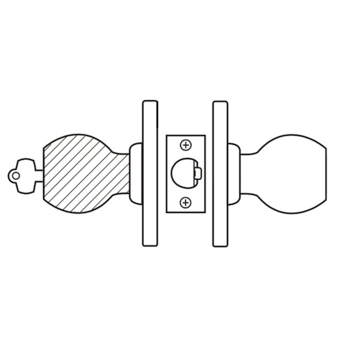

Function: ANSI No. F86
Storeroom Function Operation
Latch is operated by: Turning the key in the outside knob, rotating the inside knob
Outside Lever Locked by: Always locked
Outside Lever Unlocked by: Cannot be unlocked
Inside Lever Locked by: Cannot be locked
Inside Lever Unlocked by: Always unlocked
