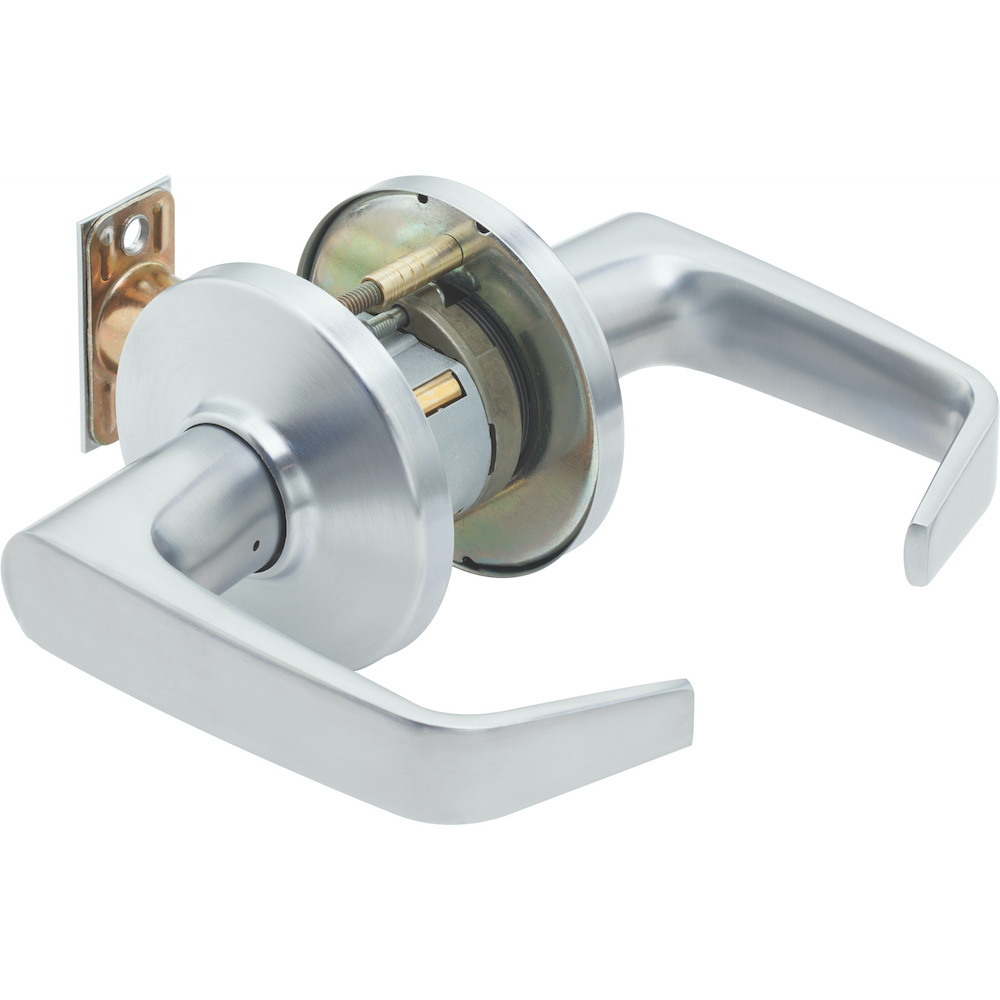

Model: 9K37D15DS3626
- 9K Series Storeroom Cylindrical Lock
- Backset: 2-3/4″
- 7-pin Core Housing accepts all Best cores
- Lever Style: Contour angle return
- Rose Style: 3-1/2″ Convex
- Strike Package S3: Conforms to ANSI A115.2 for 1-3/4″ doors (4-7/8″ x 1-1/8″ with curved lip)
- Finish: Satin chromium plated finish
- Lever Handles are high quality Zinc Alloy

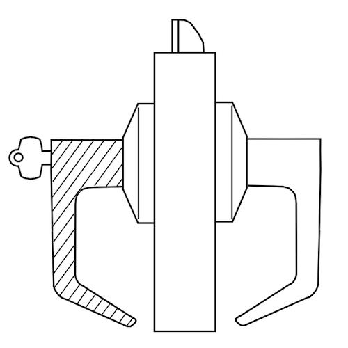

Storeroom Function Operation
Latch is operated by: Turning the key in the outside lever, Rotating the inside lever
Outside Lever Locked by: Always fixed
Outside Lever Unlocked by: Cannot be unlocked
Inside Lever Locked by: Cannot be locked
Inside Lever Unlocked by: Always unlocked
Features:
- Rose locking pin and rose assembly design offers great torque resistance. It prevents the locking pin from twisting, bending, or breaking under attack.
- The innovative design of the slotted key release cam and locking lug assembly create maximum attack resistance.
- Even though damaged, the lock still allows key access. In addition, the lever is fully functional from the inside.
- The hub-mounted torsion spring and strong retractor springs help prevent lever sag and offer a smooth and snappy operation.
- Strong through-bolt mounting studs increase torque resistance. Heavy rose liner material is highly attack resistant.
- Strong retractor springs provide resistance to lever sag.
- Zinc hubs with a shrouded locking lug, guaranteeing higher quality and increased torque resistance.
- The outside lever sleeve is a seamless one piece construction made of a hardened steel alloy that provides additional reinforcement in the locking lug slot.
*Please Note: Cylindrical Lever does not ship with interchangeable core.*
